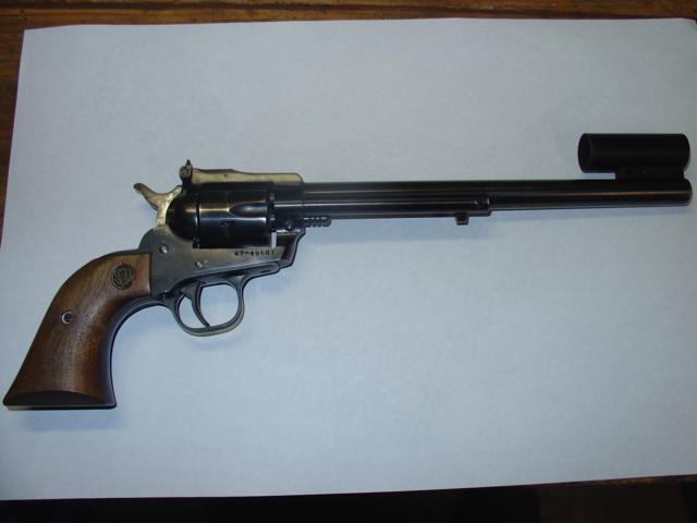

Craig, You need to put a WTB ad in the classifieds for a Ruger revolver. Don't worry about finding the Bomars for a Ruger. I put a Hamilton Bowen rear sight on mine and it is just as repeatable as a Bomar. Of course I don't have the hooded front sight but you can't have everything. Let me see how many revolvers you can collect! FAs, El Dorado's, Sevilles, Rugers, DWs, S&Ws, Colt Anaconda (44 Anaconda was great) and silhouette model VDs (NOT what you are thinking). Some great shooting revolvers out there for you.

Re: U-gun rear sight location
- single-six 9.5.jpg (27.23 KiB) Viewed 7086 times
ole - Nice Ruger. I'm very partial to Rugers.
