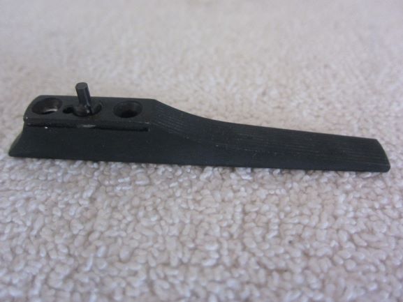

I ordered a front sight on eBay that looked like it might work: https://www.ebay.com/itm/Original-Ansch ... SwApRdkoGv
Price was ok to take a chance on. Won't be here for a couple weeks so will let you know if it works. As it would happen, since then I had a friend send me one from an original Exemplar complete with hood! Just need the M3x.05x12mm black flat head screws to attach with.
Original shown for comparison with eBay item. Post is different, not sure about the rest.
