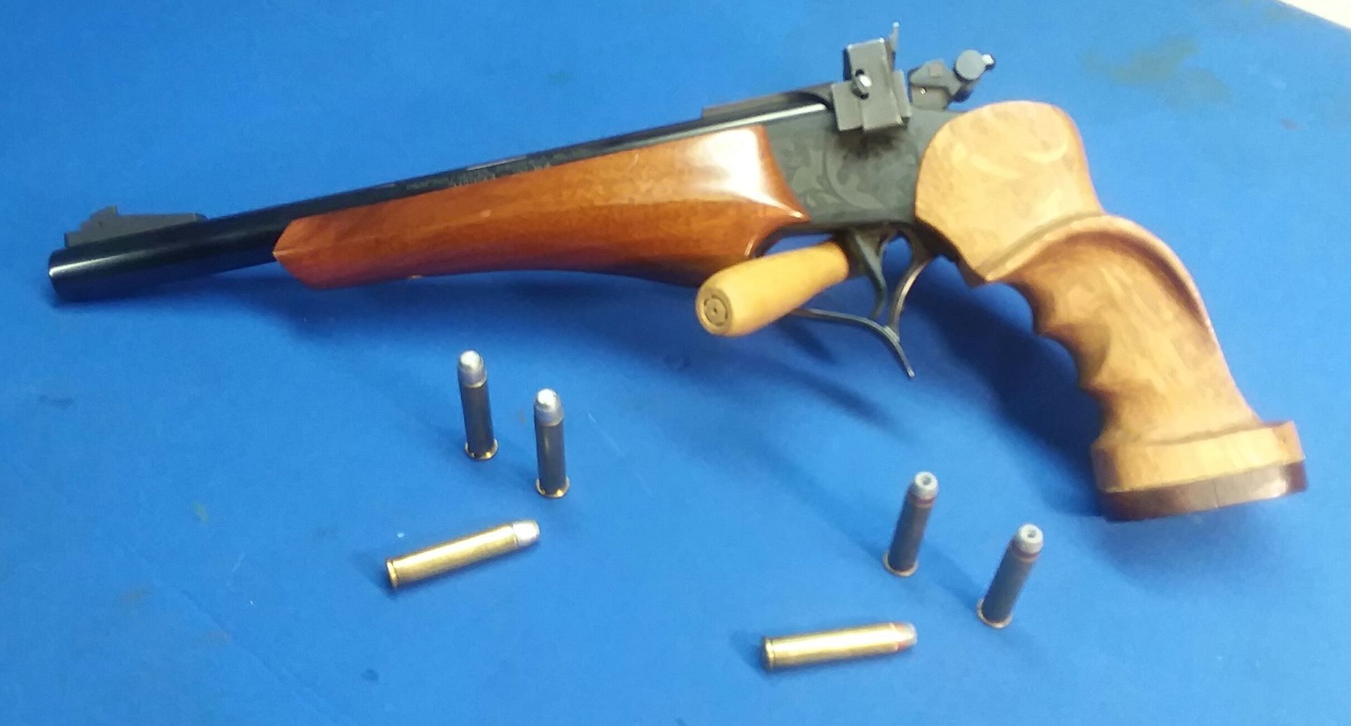

I found one link to data for the 360 DW. I am wanting more, and that link does not have 2400 data. So far, I have tried some 2400 with Speer's 4217 bullet with data for the 357 Mag. 14.5 grains loaded to 1.74" shows real promise, but unknown velocity. I really want to keep using this bullet. I also have H110 and A1680.
I plan on using this for thumping steel and hunting, so I would prefer an inexpensive load that will do both. Any cast loads also accepted.

Time to break the H110 out again. I have a rifle barrel.

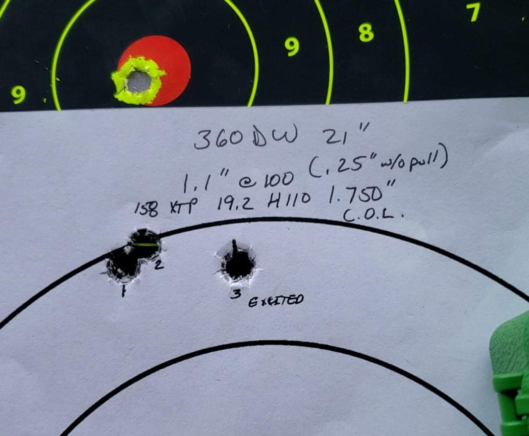

Re: 360 DW
I think I found a good load. I got excited and know the third round was off, but still just about 1MOA. I tested up to 19.5 (Dan Wesson listed starting load). This was the best group of them all.
