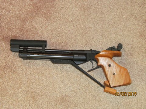

Hey guys just chasing some information and maybe some photos if possible. I am in the process of buying a IZH 46M to set up as my Silhouette Air Pistol. I have found the Martins Sights website and am thinking of ordering a front sight / hood set up to suit a taco hold style of shooting. I guess that this set up replaces the factory front sight, if so is it a straight forward job to set up? The website also mentions a rear peep adaptor and I was wondering if this is required or is the factory rear sight good enough? Does anyone have a photo of the peep adaptor attached to their pistol so I know what it is that I am actually looking at?
Sorry for the multiple questions and thank you in advance for any information provided.

Here is a pic of a IZH set up with Martens sights. The rear is a flat piece that screws in where the rear blades go. It is drilled and tapped for a screw in aperture like a Merit or a Gehmann. The front tube has a clear plastic insert with a very small hole drilled in it so you are looking at a peep on peep.
Steve does a nice job with his sights and they are nicely finished. Complete instructions are included and they are easy to install.

Thank you Jimologist for the picture and reply. I think that I might stick with the taco hold length hood and front sight. Will also stick with the standard rear sight set up at this stage and use it not only as a match gun but also try to use it as a practice set up for standing small bore, field pistol and big bore.
