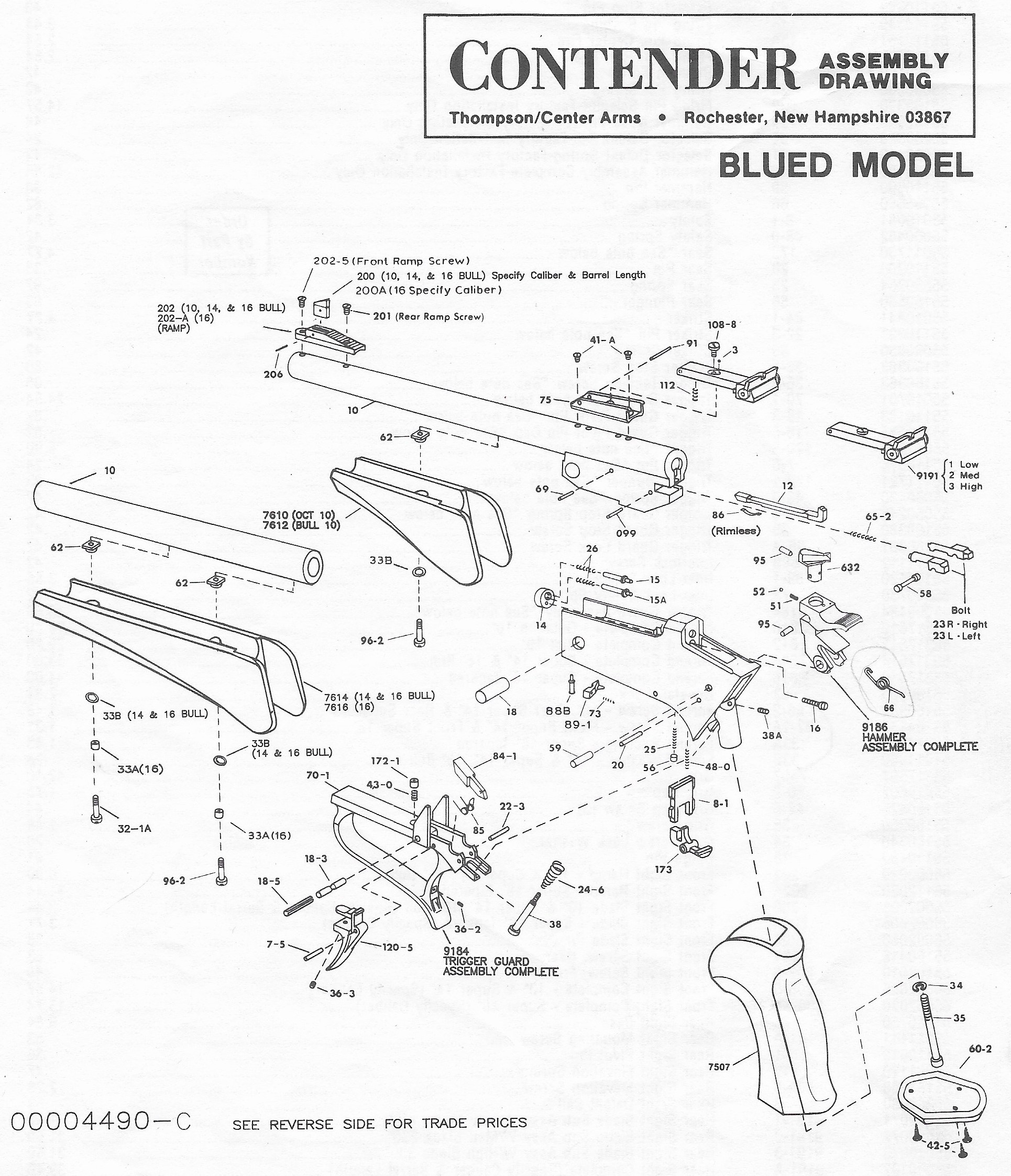

I have an older G1 frame that has the easy open conversion. I have had the G1 frame about a year and it has worked perfectly up til now. A few weeks ago I started getting light primer strikes on the 22 LR barrel. Never an issue with my centerfire barrels. The firing pins on the 22 LR barrel looked original so I swapped in new pins and springs. Worked great for about 100 rounds and then half way through our match last night it happened again. Seems like there is something else going on but not sure where to look?
Secondly, I had my G2 frame with me so I tried to put the 22LR barrel on the G2 frame to finish the match but the barrel will not lock. The 22 LR barrel is an older TC barrel with the one piece lug. Any thoughts?

on the G1 frame, you might have a weak hammer spring or the screw holding the interlock safety in place may be coming loose. to check the hammer spring, just pull the hammer back. if you do not feel any tension about 1/3 to 1/2 of the way back in pulling hammer, you need a new hammer spring. These need replacement a lot. if the interlock safety screw comes loose, the safety bar may hit the hammer and prevent a good strike. On the picture, the interlock safety screw is 88B.
