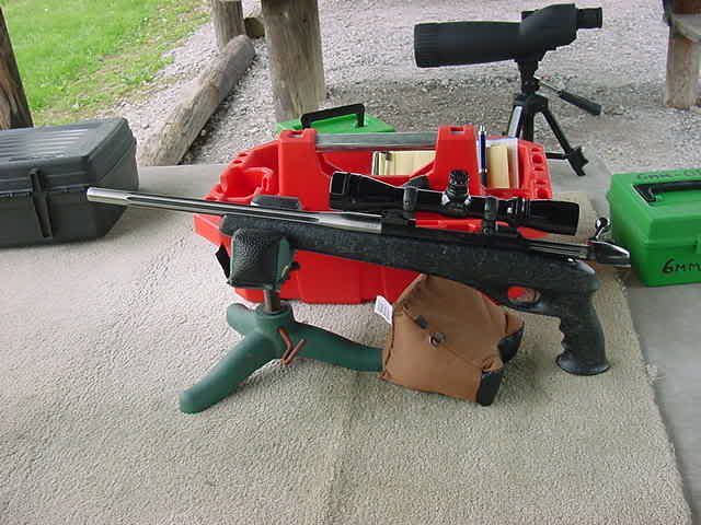

In order to build a clone of the XP I need some help. 1) action 2) barrel 3)trigger 4) stock???? Anything else? Just thinking about it and wondering if I'm on the right track. Will need someone to assemble it but where to start?? I am a rookie at building a target gun.

Defiance action, quality barrel of your choice, Mike Dewey or Dell Taylor trigger, H S Precision stock and Steve Roe of North Carolina to smith it.

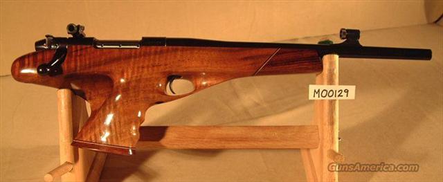

I want to do the same thing… Only different
What I would like to do is take my Weatherby CFP
And convert it to a midgrip stock in the same vein as the original Weatherby’s
