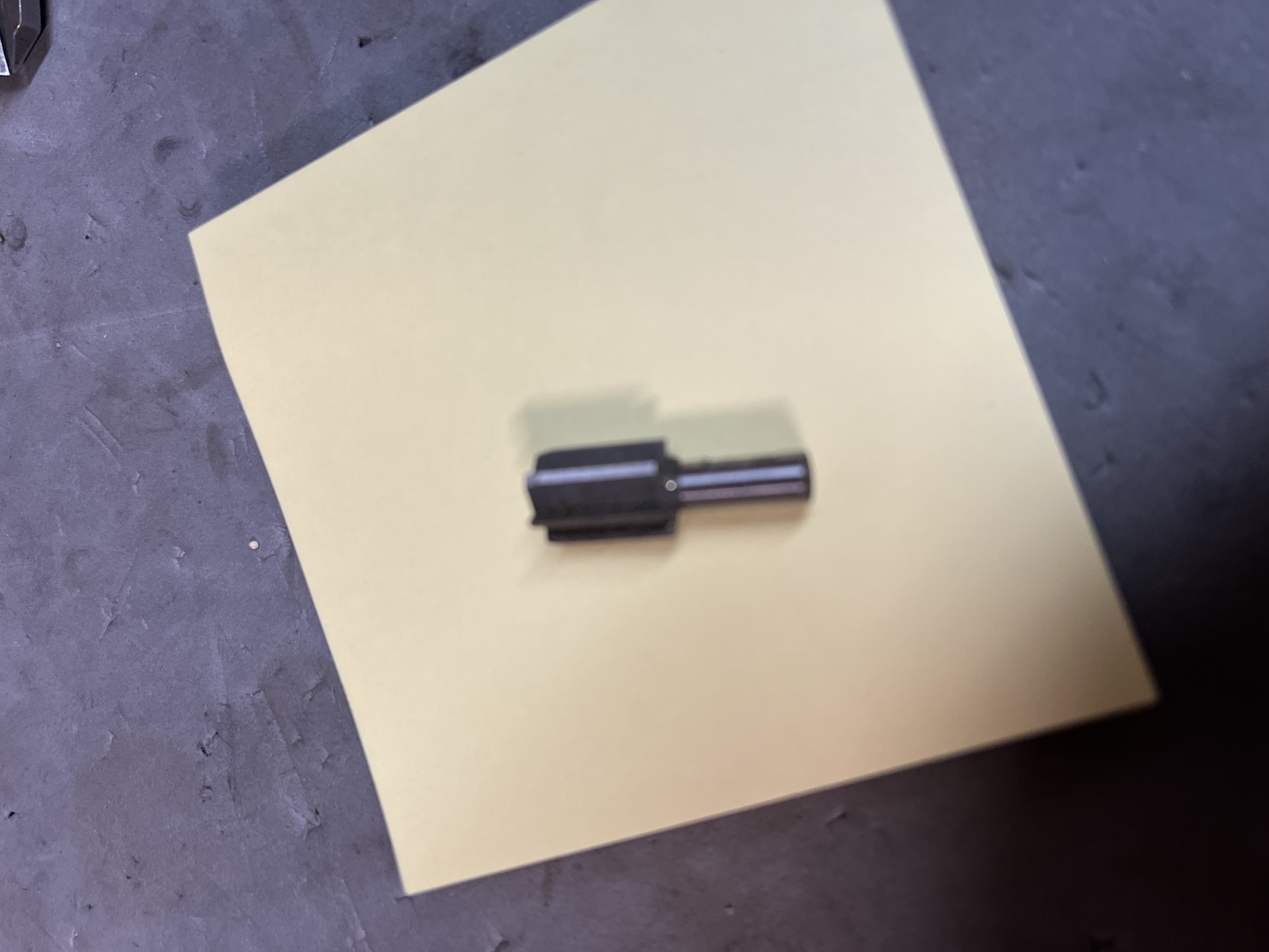

Posts: 704
Re: ".357 Match" BF Chamber
Jmoore
Here is a pic of the .358 Forster inside reamer.couldn’t get it to post on the PM
