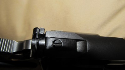

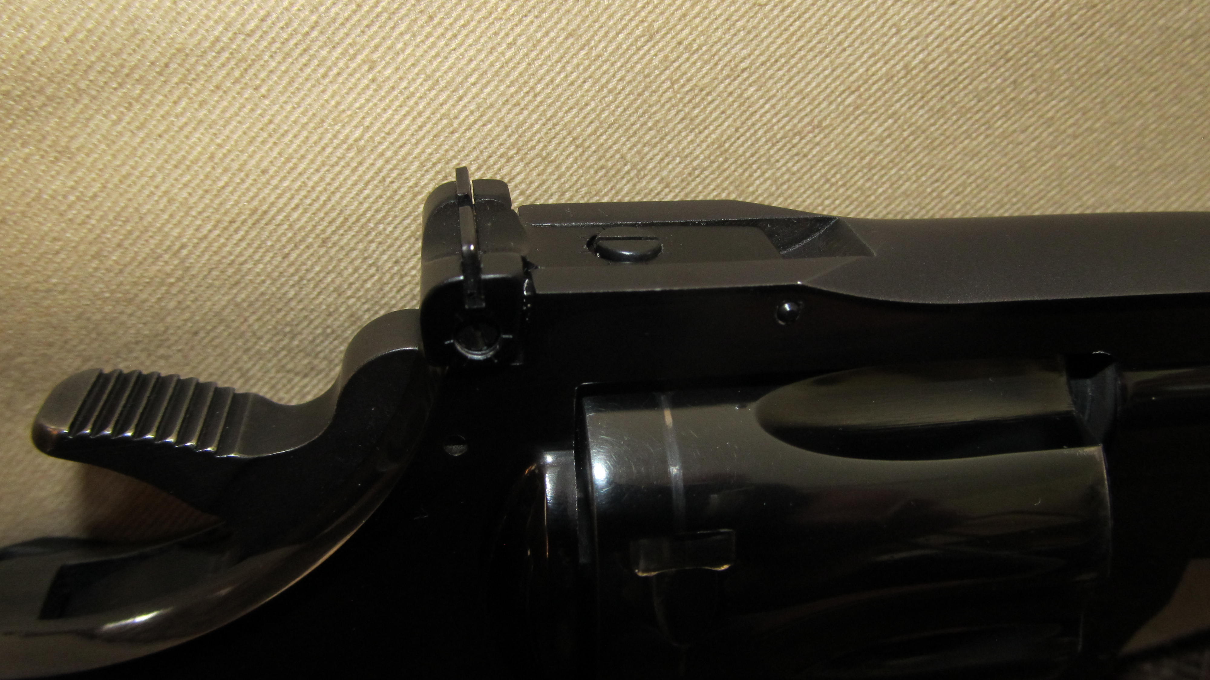

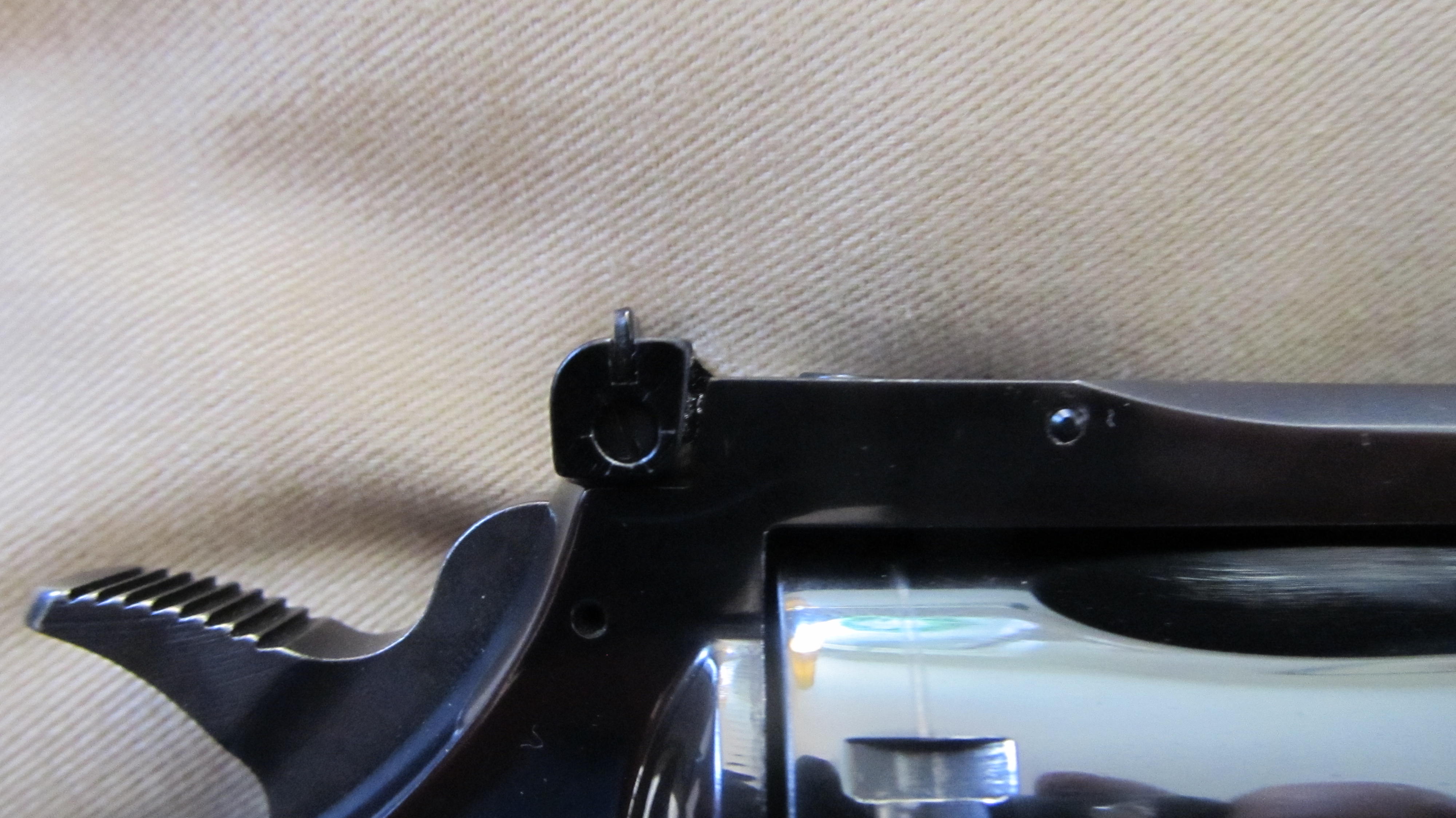

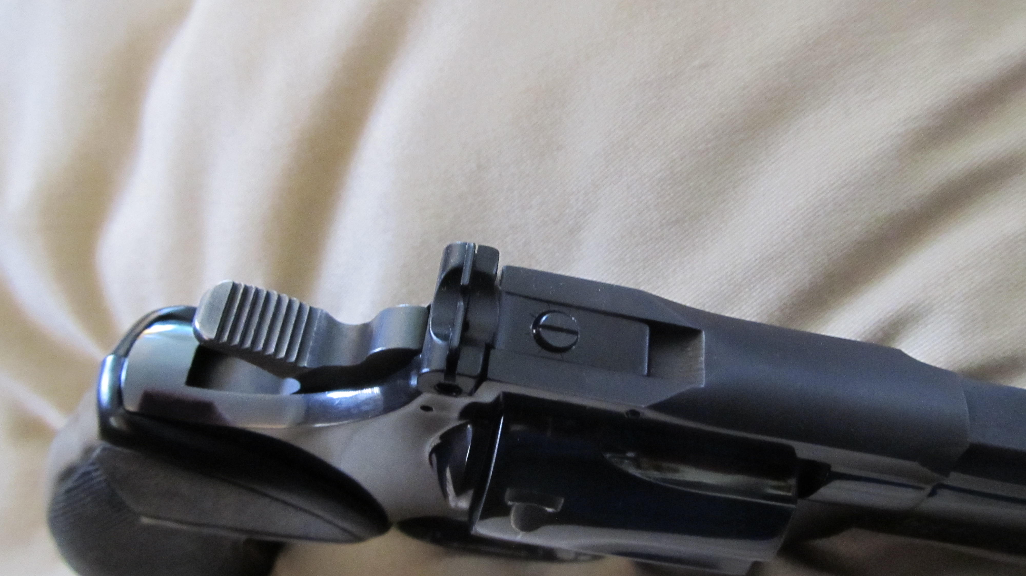

Concerning putting a Ruger sight on a Dan Wesson - the answer is yes AND no. The small frame DW's and the latter-production large frame DW's use the same rear sight. These sights have the same mounting pattern as the Ruger rear. The very early 44 DW's had the elevation screw mounted almost to the rear sight blade - Ruger will not fit ! There is , however a problem with using a Ruger sight on the other Dans - the Ruger sight has a bump on the bottom, and when installed on a DW it prevents the rear sight from bottoming out. You will have limited adjustment, and will need a very tall front blade. The only sight that can be used on a Dan without this problem is the rear sight that came on the Target model MK1, 3, and 3 semi-auto .22 pistols. They do not have the bump on the bottom. But, to get it to bottom out on the frame you will have to deepen the spring holes on the Ruger sight. I have attached pics of a DW 357 with this Ruger sight installed. I have owned a Bowen target rear sight in the past, but I cannot recall if they had the bump on the bottom. If they do, you will probably have the same problem. I have another solution that you may consider - a couple of years ago I purchased a target rear sight from CZ-Dan Wesson. Upon receipt I thought that it looked familiar, and finally figured it out. It was a clone of the old Elliason rear sights that Colt used on the Python. And the elevation screw was a different thread than the DW. I called them and they told me that the screws were the same, but the screw that they sent was wrong. I determined that they were getting their sights from Kensight, and that the Python used a thread with a slightly different pitch. Kensight had sent them the wrong screws !! He was able to scrounge one up for me, and it then installed without problem. You might contact Kensight and give them dimensions - I think that the Python Elliason sight will fit a Dan, if you can get the proper elevation screw !!
