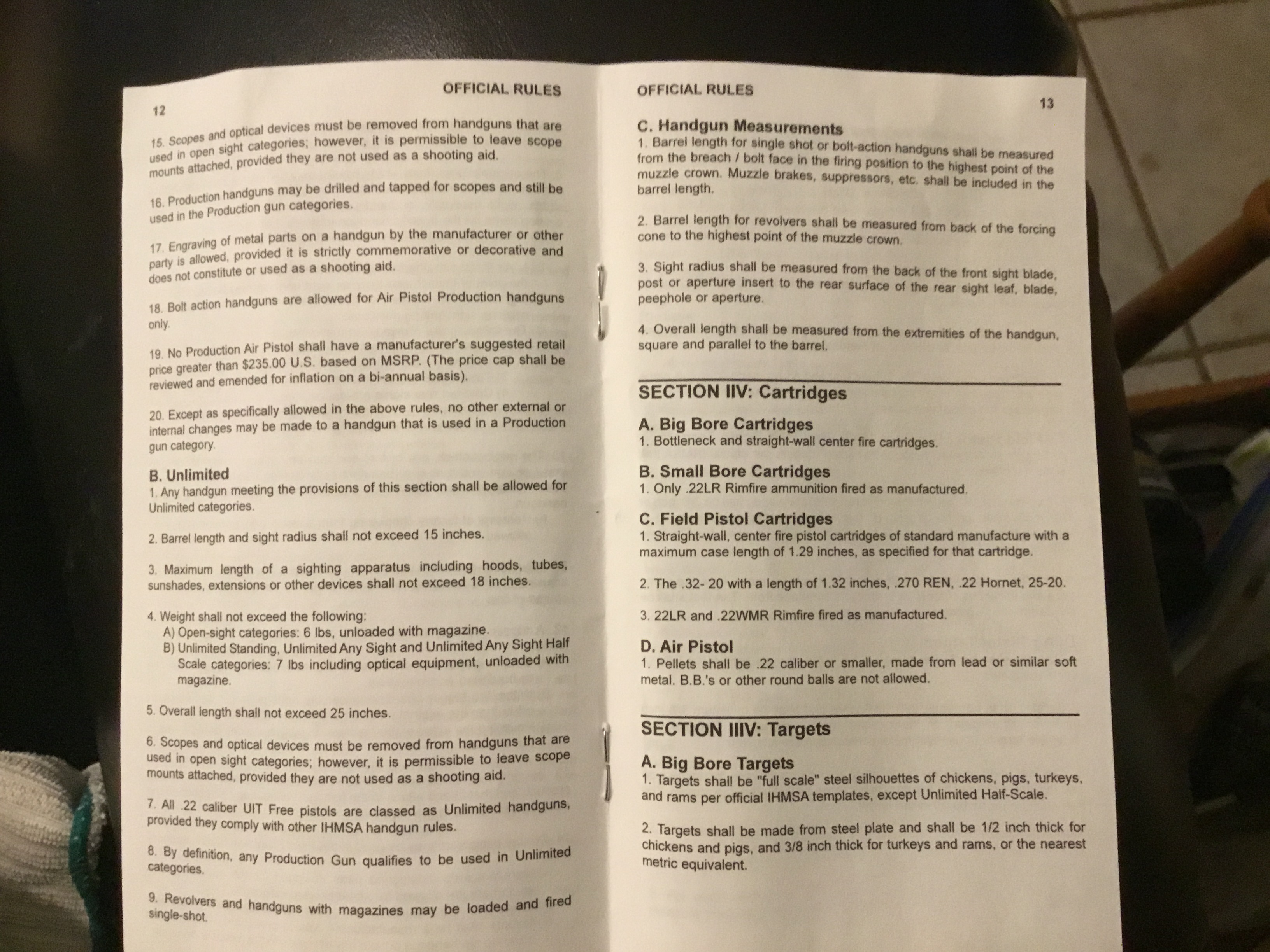

Re: Unlimited Guns & Stock Configuration Con't
I agree with 260 Striker. The 2006 official rules for unlimited. No misunderstanding the rules
