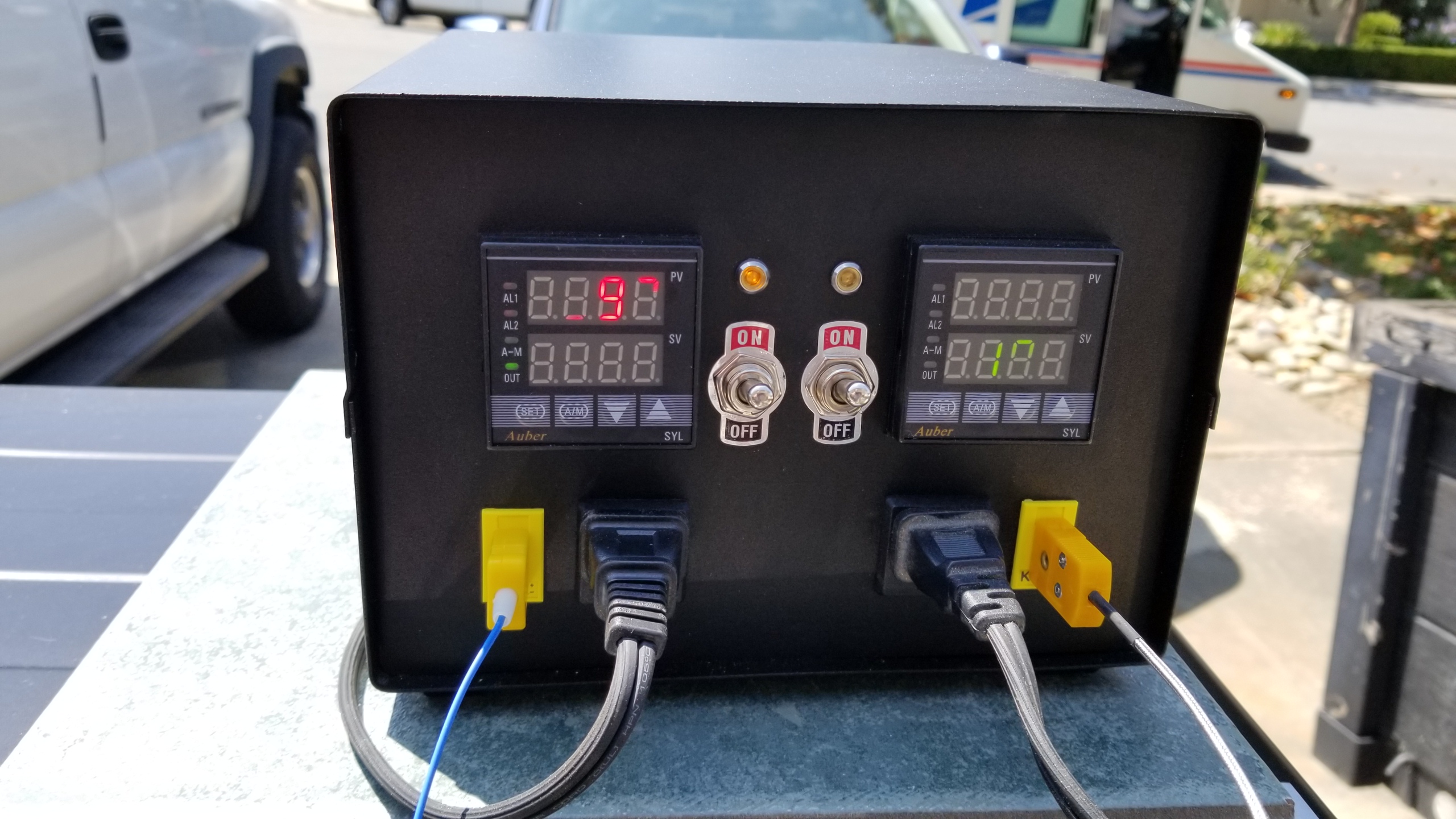

I have had the Lee 20 lb pot for about 10 years and it has poured a lot of lead without issue. To get better temperature control I built a dual PID controller using inexpensive PID controllers and solid state relays. When casting bullets one controller runs the pot and the other controller runs a single element hot plate to keep the mold(s) warm.
I also use the controller to run a small 110v silicon heating element for my RCBS lube sizer and a small powder coating oven that doubles as a cast bullet heat treating oven.
Way better heat control than the on-off cycling of the Lee pot or RCBS heater.

HMM, I have not played with a PID controller since I was in the Navy! might have to think about this!jbolt wrote: Sat Aug 10, 2019 7:41 pm I have had the Lee 20 lb pot for about 10 years and it has poured a lot of lead without issue. To get better temperature control I built a dual PID controller using inexpensive PID controllers and solid state relays. When casting bullets one controller runs the pot and the other controller runs a single element hot plate to keep the mold(s) warm.
