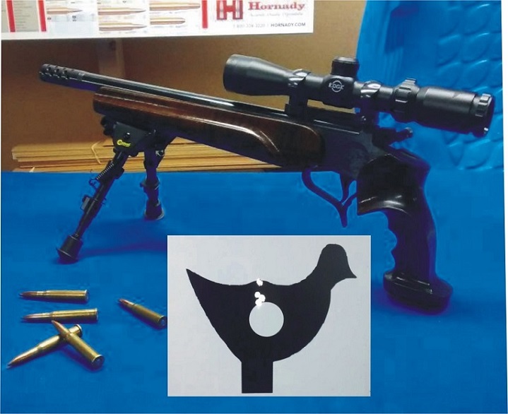

I have an XP chambered in 7 TCU that is getting long in the throat and I don't like to shake the gun to keep the bullet tip from hitting the back of the chamber while loading during a match. I was thinking about having the current chamber reamed out to something larger and then switching to a 308 size Model 7 bolt. I know the current chamber is shorted than a 7 BR and could have it reamed to 7 INT but was wondering if there was some in between 7mm cartridge. I have had several 7 INT guns in the past so wouldn't mind going that route but also like the smaller 7 BR to save powder and get same results. An in between cartridge would clean up my old chamber. What was the 7 Laser? Might still be too short if it was based upon the 7 BR. Any ideas?

If it's going to involve a gunsmith, why don't you just have a new 7TCU chamber cut on your old barrel? Gunsmith unscrews barrel, reams chamber a bit deeper (maybe .100"), cuts off an equal amount of threads, headspaces your barrel back into the action. I think that's fairly common among benchrest guys who don't want to toss a good barrel just because the breech end rifling is getting a little worn. You keep all your brass, dies, bolt, etc.
Re: 7mm in between cartridge - DUH
Rich, Actually I'm thinking of just having a smith ream out the chamber to 7 INT. That will clean up the TCU chamber and maybe make a nice clean throat too. When loading the TCU at matches about 1/2 the time the bullet nose will hit the back of the chamber while loading and I have to shake the gun to get the nose to go into the TCU chamber. Also tried to use fingers to push cartridge into TCU chamber and that works about 1/2 the time. Going to the 7 INT will make the chamber much bigger and cartridges should slide in with no resistance. Just getting picky in my old age!!!!!

Ken Waters' brainchild the 7-30 Waters

130 gr. bullet + 33.0 gr. IMR 4064 = 2200 FPS
consider a super 14 Bbl for +100 FPS
interesting read:
10" - http://www.castbullet.com/shooting/7tcu2.htm
14" - http://www.castbullet.com/shooting/7tcu.htm
in my opinion, more shooters have been lured to the contender by witnessing the performance of the 7-30 Waters cartridge in a handgun than any other cartridge.

Since you have an XP. Why not try the 7-08?

The 7/08 would make an excellent choice. I've been shooting mine for almost 8 years now. It is a tac driver, to say the least. I use a reduced load to manage recoil and I think that you might find that this would work very well for you.

7mm Super Bower
http://www.retro.co.za/gundex/articles/ ... curacy.pdf
One sweet shooter!
Surprisingly mild pressures as indicated by spent primers and manageable recoil using the rifle platform
One sweet shooter!Surprisingly mild pressures as indicated by spent primers and manageable recoil using the rifle platform

7mm Raptor uses 204 Ruger brass
747 Thunder Jet uses 222 Rem mag brass (7mm bullet)
contact Gary Reeder
contact Gary Reeder
