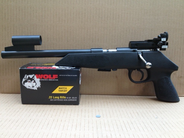

My Day one Gun
I start shooting Sunday with 2 guns scheduled FS U in the morning and SB U in the afternoon
I flip flopped a couple of times on which to shoot 1st. the FS or SB and with no real reason I went with FS 1st.
The Gun of choice for this is my Exemplar Peep on Peep. I bought this gun a couple years ago from one of the Region II greats. With no sights and original wood stock, The wood stock never really fit me but I hate to modify it I ran across this factory plastic stock that had been modify and it work much better. I added the Williams rear Peep and I machined a front sight that would accept one of Steve Martens clear peep disk and that would meet the sight radius rule. I had tried one of the clear disk on a couple of standing guns but never felt comfortable with it But decided to give it a try on this gun mainly because the plan was to use it for both FS U and SB U thinking using the center hold with the peep compared to the 6 o’clock hold of a post I could somewhat use the same sight settings for both and it has somewhat works out. Last year I shot the gun as is in UAS FS UAS U and FS U I really think using the same gun for multiple disciplines has helped my learning curve. :|
This gun has moved me up to “AAA” in SB U with a couple 38’s and “AA”+ in FS U with a 34
I think down the road It might just pull a 40 out of the hat. ;)
T-16 and counting *-:) 8-x
