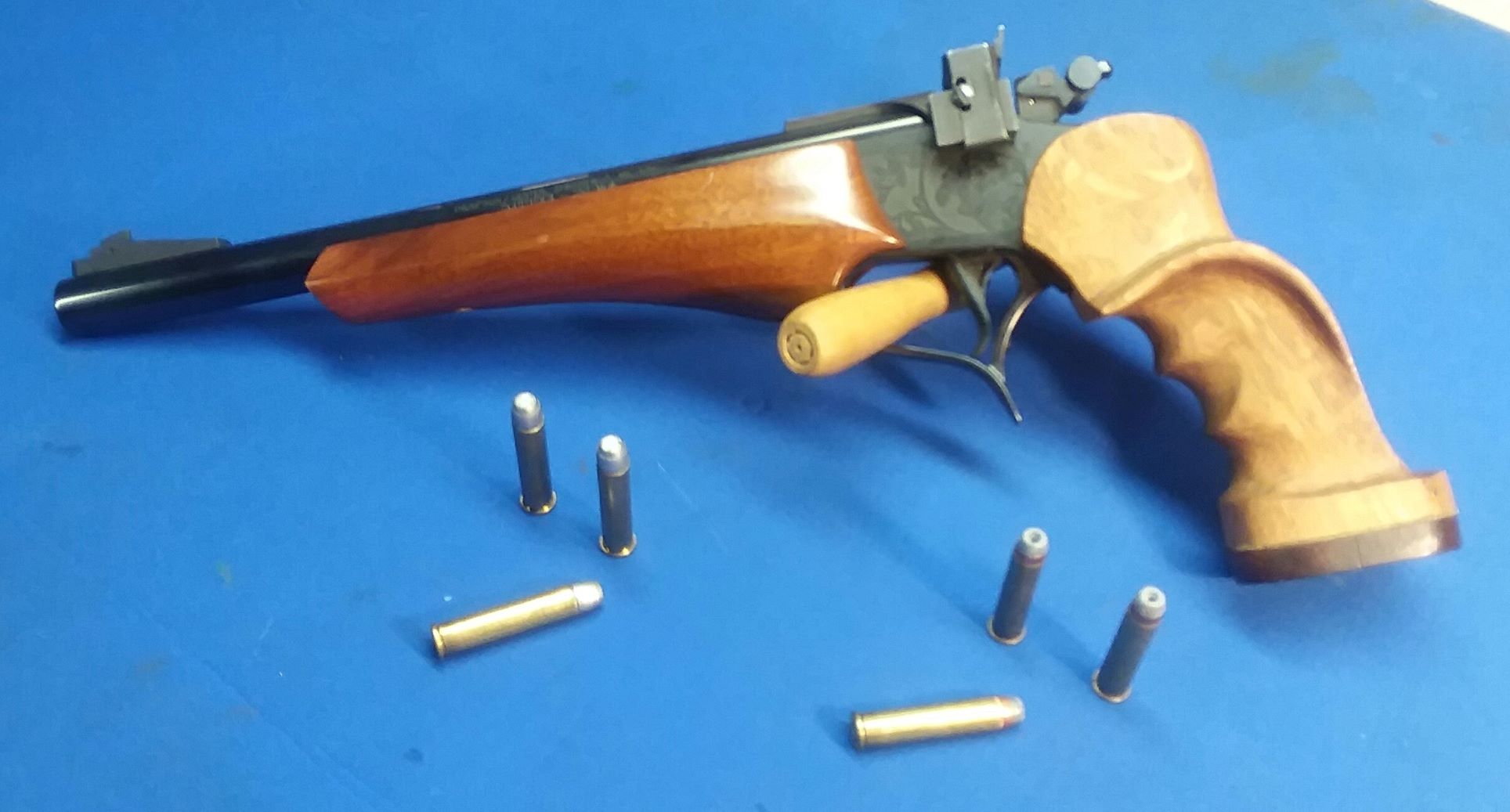

Post by gemihur »
redleg,
Since you wanna stay with a 158 gr. bullet stick with H110.
I use 360 brass in my maximum when maxi brass gets scarce.
I shoot contenders and like the heavy bullets ... 180 gr. cast.
I load 20 gr. W296 and could go more but don't need to.
The DW loads can handle more than the magnum but not the maximum.
Start with 15.5 gr. of H110 behind your bullet and work up from there.
You'll find your accuracy peaks somewhere around 16.2 gr. depending on your barrel length.
Good luck.
Jimmy

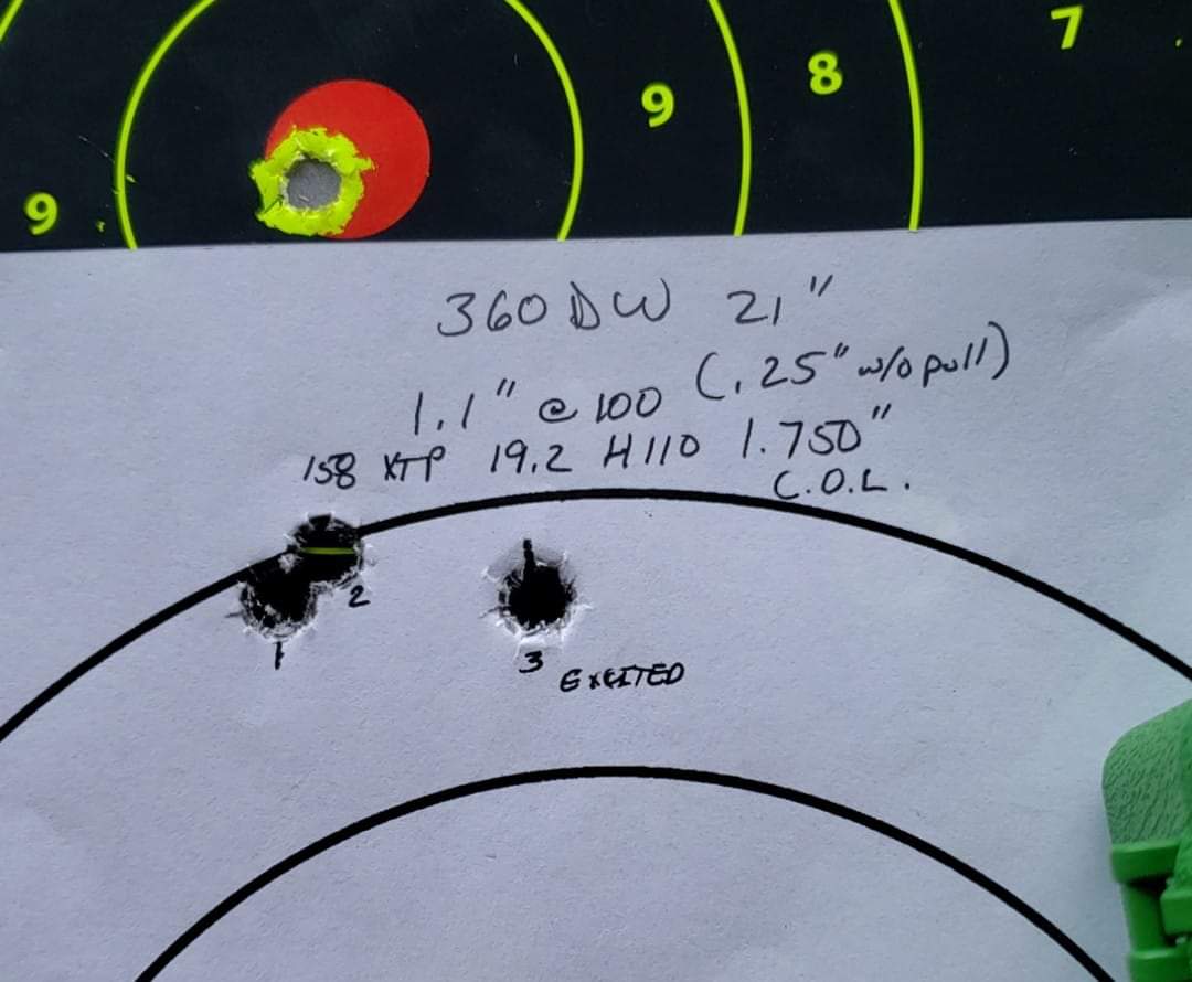

Re: 360 DW
Post by Redleg11B »
I think I found a good load. I got excited and know the third round was off, but still just about 1MOA. I tested up to 19.5 (Dan Wesson listed starting load). This was the best group of them all.
