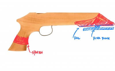

I am considering the installation of an accessory rail to be used in conjunction with a flat, non-contoured, riser block on the forend of my handgun for UAS Freestyle competition. My interpretation of the rules indicates this configuration would be IHMSA-compliant.
Are there any supporting, or differing, opinions out there?

a picture would help. But since it is an unlimited gun, you have a lot of leeway. as long as you meet weight and length limits and cannot be used as artificial support, it should be fine.
most restrictions are on production guns.

Here is a sketch of what I’d like to do ...

ok, I think I have figured out this is for an exemplar.
it should be fine. if this was for a centerfire gun, that riser may tear you up.
but, it should meet the rules. I hope the flop shooters chime in as they can give you more reccomendations.

I see no problem,l would suggest adding weight to the stock,that’s one of the problems with the Anschutz they’re very light.

With scope, you can go up to 7 lbs. Wheels are optional. :-ss
