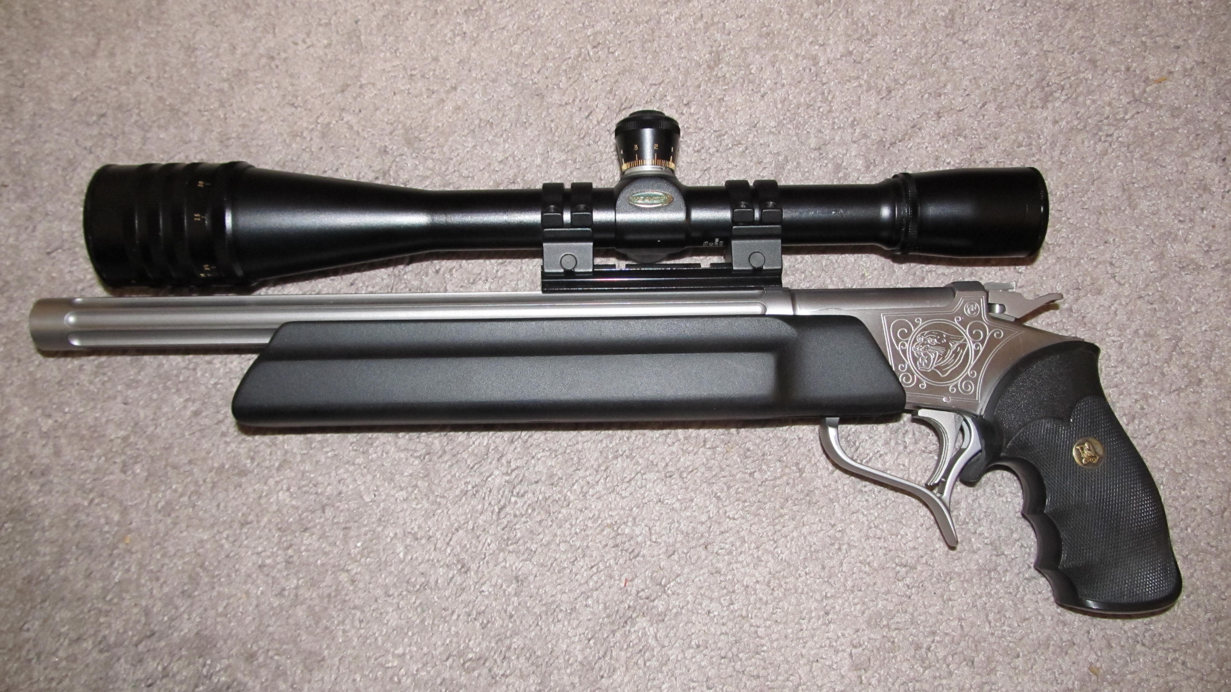

- Posts: 664
Re: Contender caliber for flop
UPDATE : Decision on flop TC has been made ! Thanks to my friend Melvin Calliham, I have a custom, fluted step 6 TCU barrel. 15" 1-8"twist' I am hoping to load this down enough to use with out a muzzle brake (I would hate to lose barrel length !) Stainless barrel, stainless frame, fitted with a Weaver T24 scope. Ready for load testing, going to first try powders on hand: AA2015, 748, IMR4064, and IMR4895. Melvin included some Nosler 107 gr. Custom Competition bullets, so those will be tried as well. I may have to modify this forend, and I have a shortened Pachmayr Gripper to use on it as well - full-size grip for load development. Wish me luck !
