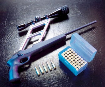

In the course to this effort, I managed to win three IHMSA International Championships, even though I still don’t consider myself a Top Gun in the event.
XP100 with custom Douglas 7mm BR barrel, Ken Light High Rise, Weaver KT-15
rifle scope, McMillan stock, Rifle Basix trigger

The
use of a High Rise scope mount, as manufactured by Ken Light, greatly reduces
and redirects recoil. The off hand holds the front bell of the scope, which
subdues the upward impulse of recoil (like a mild muzzle brake); the shooting
hand/arm on the rear grip acts as a pistol to absorb rearward recoil. When used
with moderate loads, this set-up reduces and redirects recoil significantly.

Weaver’s KT15 is a lightweight and inexpensive entry
level target scope. Image quality is good, but 15X can be a limiting factor as
skill level increases. Features heavy duplex reticle.
All around top choice is the Leupold 6.5x20 (40mm
objective) because of its light weight and useful range of magnification.
Expensive, but worth it. Reticle can be ordered as Leupold target with .006
target dot, which equates to about ½ MOA at 20X. This scope is also suitable to
be “bumped” to higher power by Premier Reticle (540-868-2044) or Optical
Services (505-589-3833). Leupold’s 8.5-25X (40mm) would also be an excellent
choice.
Leupold 12X target scope with same reticle
suggestion as above and one elevation turret, bumped to 18X. This scope is very
lightweight, even after the bump and image quality is fantastic. A less pricey
alternative to the Leupold variable models.
I have used these scopes extensively on my
silhouette pistols and rifles, so I am confident of their capabilities. I
currently use the Tasco, set at 32X, for all my .22 US shooting with the
Anschutz. My Big Bore XP100 US gun has the Leupold 12X, bumped to 18X. (The
500m US gun has a Weaver 24X Target scope – a heavier scope that might be
considered with the new weight limits for IHMSA.)
