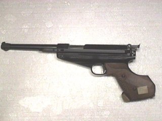

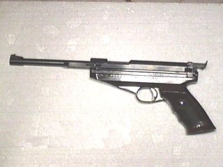

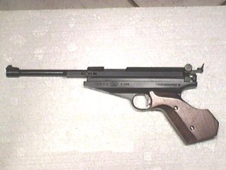

Shown above pictured left to right, FWB65-1, TFSS2-1, and the TITAN -s1
